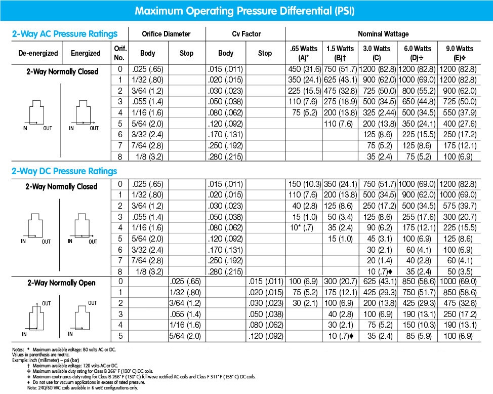

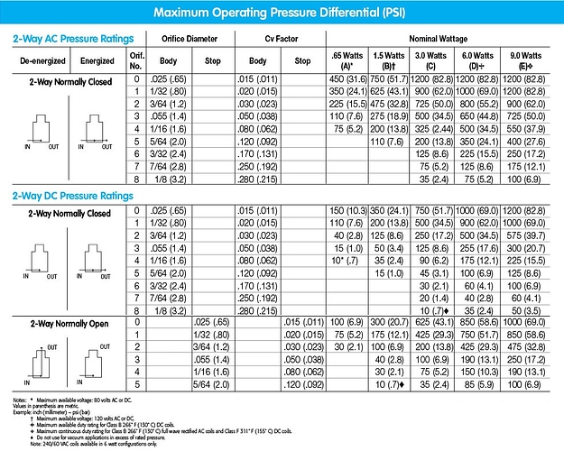

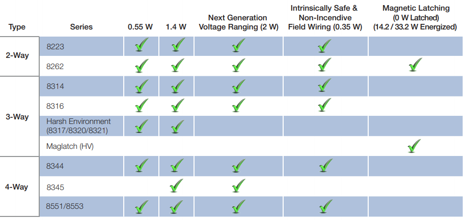

Low Power solenoid valves are the ideal choice for customers seeking to reduce their power consumption without compromising performance.
With wattages as low as 0.48 watts, the valves can be used in a variety of industrial, commercial and process applications ranging from plant control systems with low power limitations to offshore and other remote installations using solar panels or batteries.
ASCO Low Power valves allow power 4 generation and power storage equipment size to be minimized for considerable savings and are suitable for General Purpose service and environments requiring Intrinsic Safety and Non-Incendive Field Wiring. Certified by Exida, the valves are SIL 3 capable per IEC 61508 and carry UL, CSA, CE and FM approvals.
