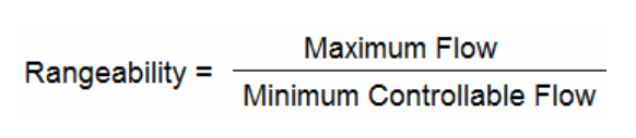

Rangeability indicates the extent of flow values that the valve can reliably regulate and is often reported as a ratio of the largest to the smallest flows that can be controlled acceptably.
A control valve with higher rangeability will control flow over wider flow rates. For example, a valve with a rangeability of 50 and having a total flow capacity of 100 GPM, will control flow accurately down to as low as 2 GPM ehen fully open. Rangeability is affected by three factors:
