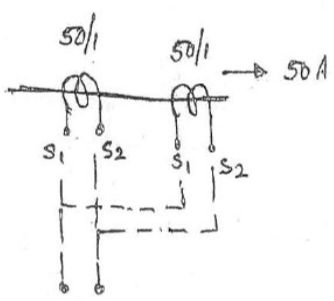

What will be the ratio of connected Combined CTs?
A. 100: 1
B. 2500:1
C. 1:1
D. 50:1
Answer: D
A. 100: 1
B. 2500:1
C. 1:1
D. 50:1
Answer: D
