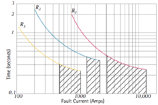

What you are analyzing from this graph?
A. R1 will operate faster than R2 and R3 at 1000A fault current
B. R2 will operate faster than R1 and R3 at 1000A fault current
C. R3 will operate faster than R2and R1 at 1000A fault current
D. None of the above
Answer: C
