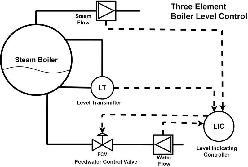

Boiler drum level control is necessary to feed water into the boiler as steam is output into the header and to the associated process equipment. For a given volume of steam and blowdown leaving the steam drum, an equal amount of water should replace in the boiler. There are three main control options available for drum level control, Single Element Control, Two Element Control, and Three Element Control.
