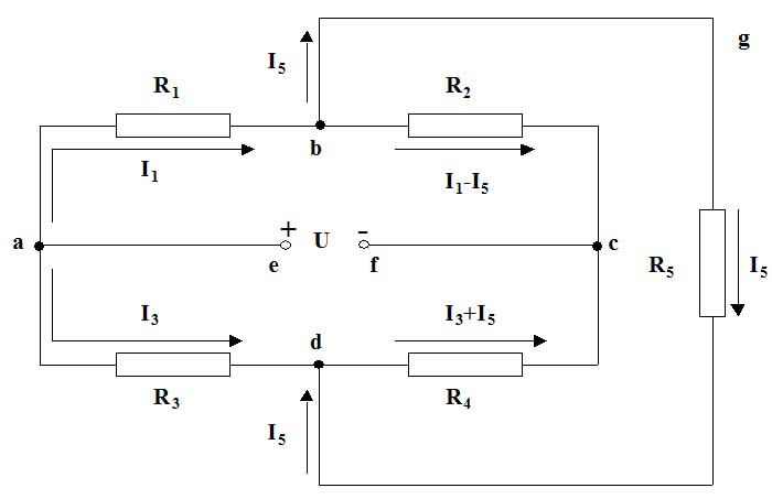

Below I give you the derivation of the balanced condition for a Wheatstone bridge. Figure shows a circuit of five electrical resistors connected to form the Wheatstone bridge.
Figure .: Wheatstone bridge.

Now, let’s consider several closed circuit loops and apply the above law to them.
- Loop e-a-b-c-f-e :
equation 4
- Loop a-b-g-d-a
equation 5
- Loop b-c-d-g-b
equation 6
Here, U is a dc voltage, and U≠ 0.

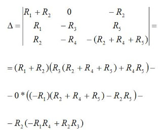

Now we evaluate the determinant of the matrix developed using this set of equations:
equation 13

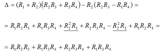

In the case of the Wheatstone bridge the resistance R5 is substituted by an ampmeter. Ampmeters have a negligibly small resistance, so we can write that R5 = 0. With this condition we can re-write (13) as follows:
equation 14
Because all Ri > 0 we have that ∆ > 0 and ∆ ≠ 0.

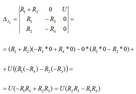

For current I5 we have:
equation 15
Now we can evaluate the value of the current, which flows through an ammeter as follows:
equation 16
