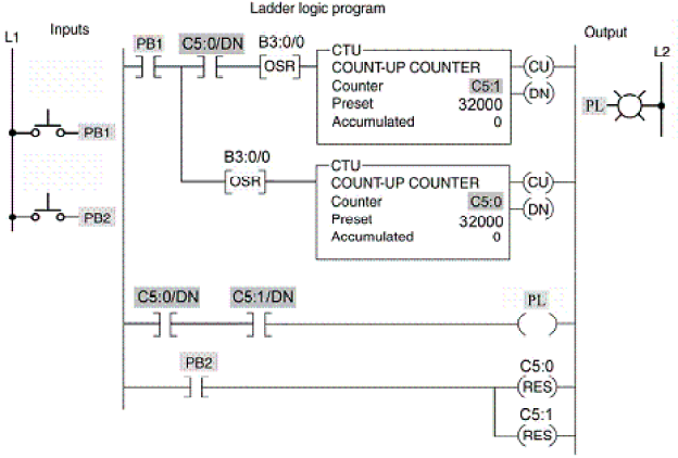

When input PB2 is actuated:
A. output PL is switched off.
B. counter C5:0 is reset.
C. counter C5:1 is reset.
D. all of these
Answer: D
D. all of these
Answer: D
