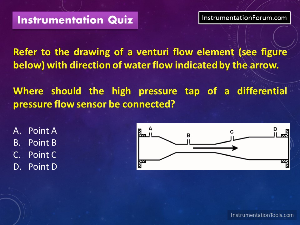

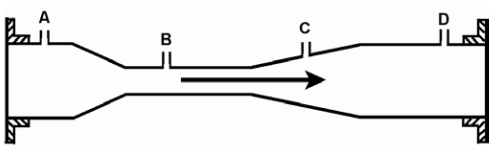

Refer to the drawing of a venturi flow element (see figure below) with the direction of the water flow indicated by the arrow.
Where should the high-pressure tap of a differential pressure flow sensor be connected?
A.Point A
B.Point B
C.Point C
D.Point D
ANSWER: A
