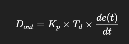

The Derivative (D) term depends on the rate of change of error — that is, how fast the error is increasing or decreasing.
Mathematically:
Where:
  • ( de(t)/dt ) = rate of change of error
  • ( Td ) = derivative time
This means:
  • If error changes rapidly → Derivative output is large
  • If error changes slowly → Derivative output is small
  • If error is constant → Derivative output is zero
Derivative action provides predictive behavior, helping reduce overshoot and improve stability.
