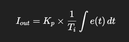

The Integral (I) term depends on the accumulated history of error over time.
Mathematically:
This means the controller:
  • Continuously sums past error values
  • Increases output if error persists
  • Decreases output if error reverses
Even a small constant error, if present for a long time, will cause the integral term to grow until the steady-state error becomes zero.
