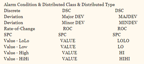

InTouch classifies alarms into several general categories based on their characteristics. These categories are known as Class and Type. The Distributed Alarm System categorizes all alarms into five general Conditions: Discrete, Deviation, Rate-of-Change, Value, and SPC.
The table below summarizes the alarm condition for both systems:
