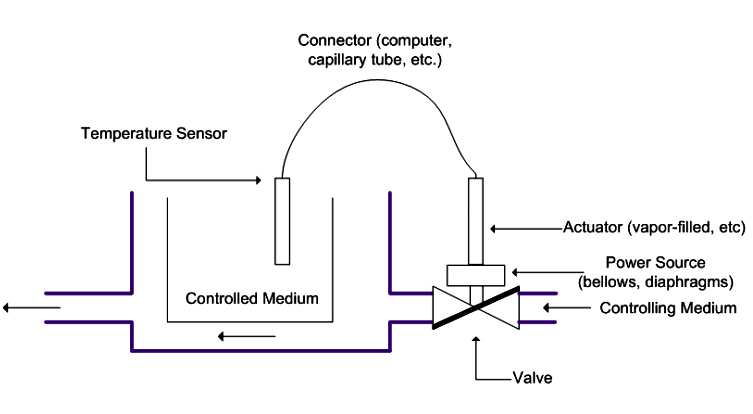

Structure
The structure of a typical thermal regulator consists of four main parts, as shown in Figure.
The temperature detecting element, which in most cases is a temperature sensor, as described above, sends either an electrical or mechanical signal through the connector to the actuator.
The actuator then uses this signal to act upon the power source, which determines the position of the valve.
Note: The actuator consists of the capillary tubing, the power source, and the adjustment.
Figure . Schematic Diagram of Temperature Regulator Structure
Operation
The temperature regulator operates based upon a mechanical means of temperature control. As previously mentioned, the bulb of the regulator is typically filled with a heat conducting substance.
Due to the thermal expansion properties of this substance, the substance expands as the temperature increases. This expansion causes a change in the pressure of the actuator, which correlates to the temperature of the medium.
This pressure change repositions a valve on the regulator, which controls the flowrate of a coolant. The temperature of the medium is then altered by the change in the flowrate of this coolant.
