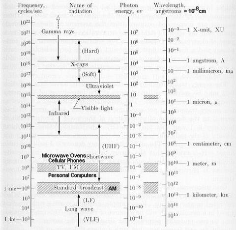

X rays are electromagnetic radiation. All X-rays represent a very energetic portion of
the electromagnetic spectrum (Table 1) and have short wavelengths of about 0.1 to 100 angstroms (Å). They are bounded by ultraviolet light at long wavelengths and gamma rays at short wavelengths X-rays in the range from 50 to 100 Å are termed soft X-rays because they have lower energies and are easily absorbed.The range of interest for X-ray is approximately from 0.1 to 100 Å.
