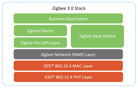

Zigbee builds on the physical layer and media access control defined in IEEE standard 802.15.4 for low-rate wireless personal area networks (WPANs). The specification includes four additional key components: network layer, application layer, Zigbee Device Objects (ZDOs) and manufacturer-defined application objects.

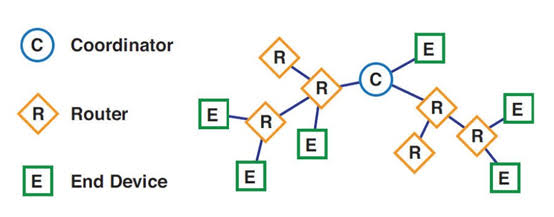

Zigbee devices are of three kinds:
Zigbee Coordinator (ZC): The most capable device, the Coordinator forms the root of the network tree and might bridge to other networks. There is precisely one Zigbee Coordinator in each network since it is the device that started the network originally (the Zigbee LightLink specification also allows operation without a Zigbee Coordinator, making it more usable for off-the-shelf home products). It stores information about the network, including acting as the Trust Center & repository for security keys.
Zigbee Router (ZR): As well as running an application function, a Router can act as an intermediate router, passing on data from other devices.
Zigbee End Device (ZED): Contains just enough functionality to talk to the parent node (either the Coordinator or a Router); it cannot relay data from other devices. This relationship allows the node to be asleep a significant amount of the time thereby giving long battery life. A ZED requires the least amount of memory, and, therefore, can be less expensive to manufacture than a ZR or ZC.
