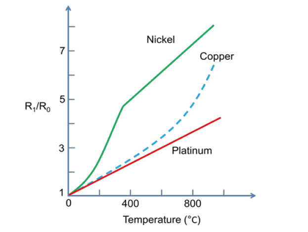

RTDs work on the principle that the electric resistance of a metal changes due to change in its temperature.
On heating up metals, their resistance increases and follows a linear relationship as shown in Figure.
The correlation is
where Rt is the resistance at temperature T (⁰C) and R0 is the temperature at 0⁰C and α is the constant for the metal termed as temperature coefficient of resistance. The sensor is usually made to have a resistance of 100 Ω at 0 °C

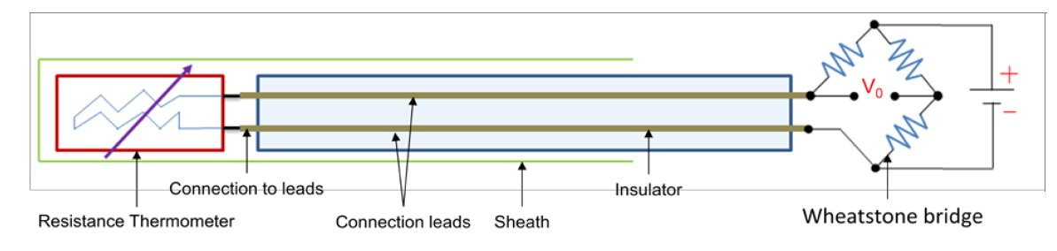

Construction of a Resistance temperature detector (RTD)
The above Figure shows the construction of a RTD. It has a resistor element connected to a Wheatstone bridge. The element and the connection leads are insulated and protected by a sheath.
A small amount of current is continuously passing though the coil. As the temperature changes the resistance of the coil changes which is detected at the Wheatstone bridge.
