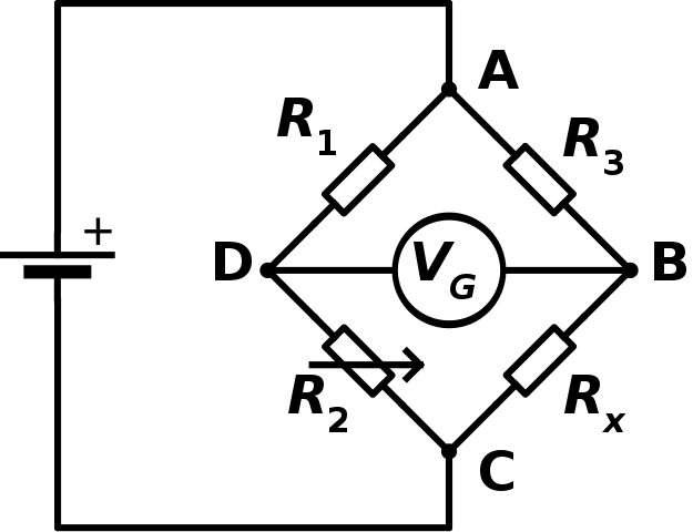

Figure : Wheatstone bridge circuit diagram. The unknown resistance Rx is to be measured; resistances R1, R2 and R3 are known and R2 is adjustable. If the measured voltage VG is 0, then R2/R1 = Rx/R3.
