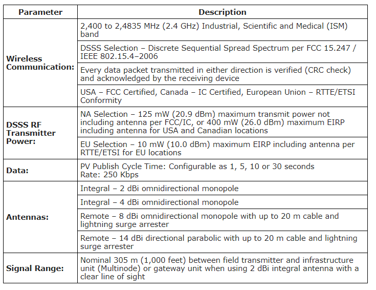

Each XYR 6000 transmitter is battery powered by two long-life “D” size lithium batteries. These batteries have an expected lifetime of up to ten years. Transmitter range with the integral antenna is 1,000 ft. (305 m) line of site (LOS) under ideal conditions.
XYR 6000 wireless transmitters send information to the Honeywell OneWireless industrial network. This network includes OneWireless Multinodes, or wireless access points. The OneWireless Multinodes and gateways form a highly-reliable and secure industrial wireless MESH infrastructure. The Honeywell OneWireless Network ensures reliable and fast transmission of field information into Experion PKS or any other control system wirelessly via OPC client or Modbus-TCP.
