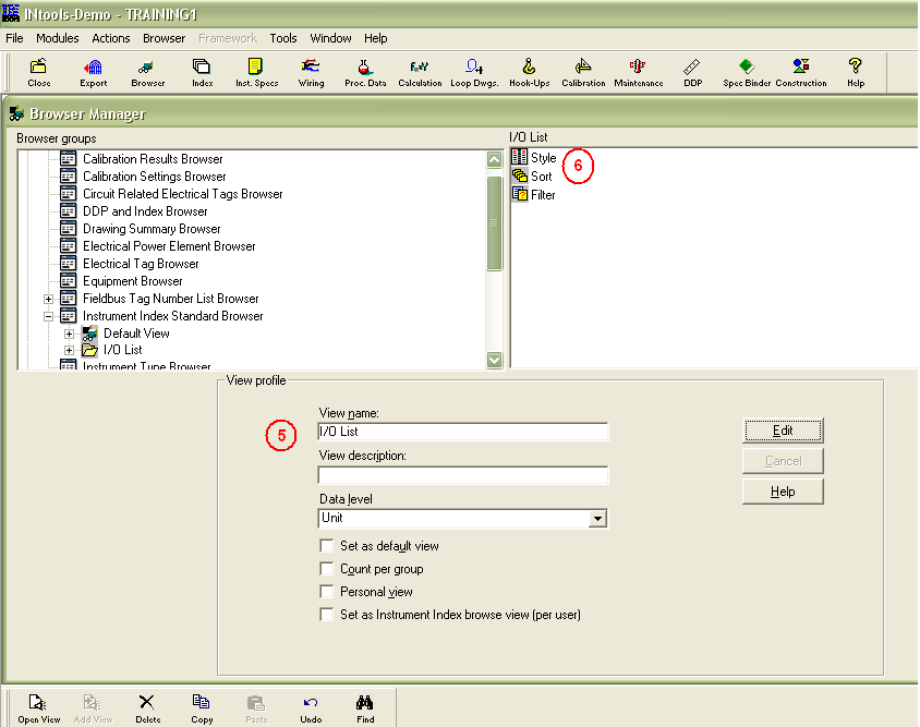

Open Instrument Index Browser
Expand “Instrument Index” Folder
Click “Instrument Index Standard Browser”
Click “Add View”
Type “I/O List” in view name field and SAVE
Click Style
Click “Edit”

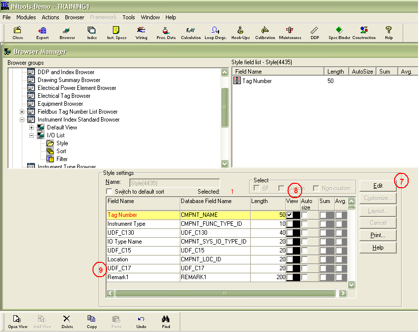

Check the box under column view for field which will be shown in I/O list view.
There are spare fields named UDF_CXX which can be used as custom field such as logic descriptor, signal type, etc if necessary.
Save

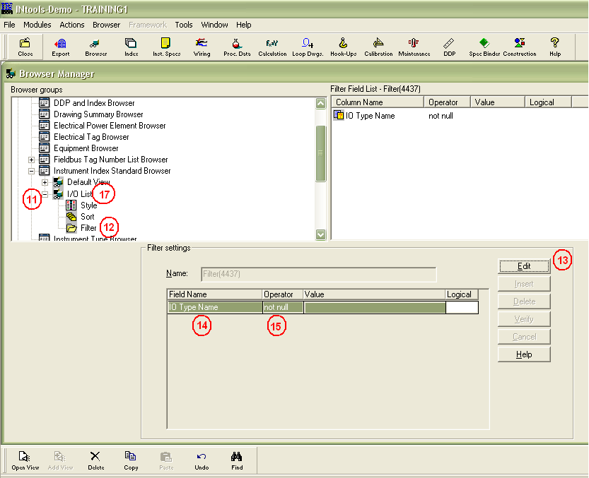

Filtering in Intools browser module
Expand the I/O List View
Click “Filter”
Click “Edit”
Select “IO Type Name” in Field Name
Select “not null” in Operator
Save
Step 14 and 15 will filter the index and shows only the tag number which has an I/O.
