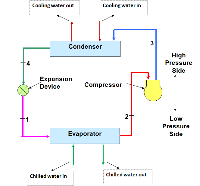

An HVAC chiller works on vapor compression or vapor absorption cycle.In vapor compression cycle, refrigerant circulates in evaporator ,compressor, condenser and expansion valve of a chiller. A thermodynamic process occurs in each of above chillers.Theoretical working of Vapor compression or compression chillers is explained below.
Heat addition to refrigerant in evaporator (1 - 2) :
Refrigerant gets vaporized by taking heat from chilled water in evaporator thus serving its prime purpose. Refrigerant comes out of evaporator as vapors but on other side chilled water is produced. Thus heat is added to refrigerant at constant pressure but is extracted from chilled water. Both refrigerant and chilled water don’t get mixed and are separated by some solid wall in between them in evaporator like shell and tube design.
Compression of refrigerant vapors in compressor (2 - 3):
Figure - Working Principle of Water Chillers
Refrigerant vapors come out of evaporator and then compressed by chiller compressor to high pressure and temperature. Compressor requires energy input for its working and hence electric energy is supplied to it.
Heat rejection by refrigerant in condenser ( 3 - 4 ) :
Similar to evaporator ,but reverse is happening here. Refrigerant rejects its heat to outside cooling liquid or air .In this way, refrigerant gets condensed and outside media is heated. outside media e.g. cooling water may be cooled by cooling tower and recycled again into condenser.
Expansion of refrigerant in expansion valve ( 4 -1 ) :
Refrigerant in condensed form coming out of condenser is expanded in expansion valve and its pressure and temperature is reduced to level of evaporator so that above cycle is repeated again.
In above four components of hvac chiller ,evaporator is the part where we get chilled water after exchanging heat with refrigerant .

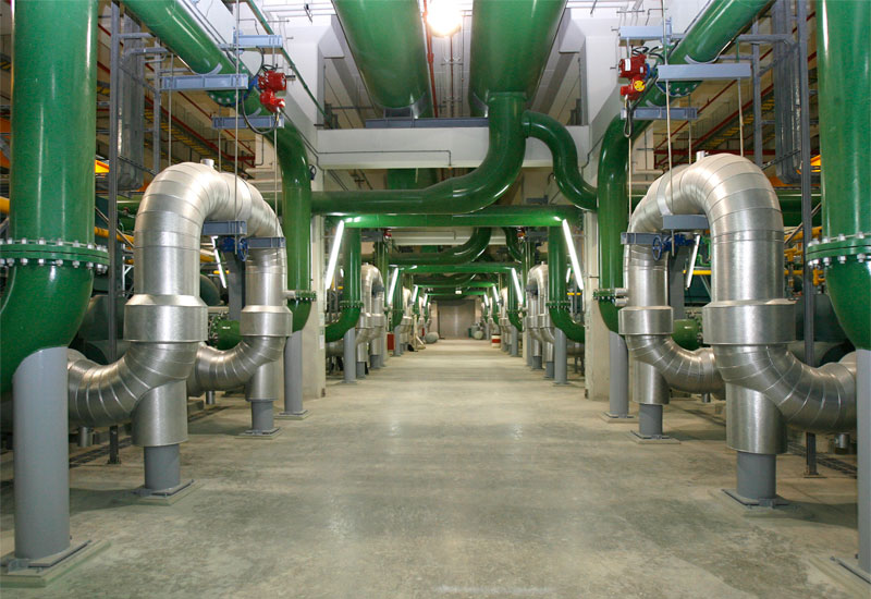

HVAC CHILLER / COOLING PLANT IMAGE :
